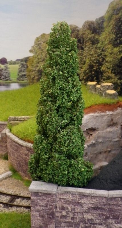

A bit more experimentation. I thought that the contrast between the GWR Loco Green paint that the tree was sprayed with and the leaves was too marked, so I took another of the trees as it arrived, and applied the Layering Spray and leaves to that ...
... which I think actually looks rather better.
I have 10 of these poplars - I got them from The Model Tree Shop https://www.themodeltreeshop.co.uk/ They were a multi-buy offer, so 10 was a good price.

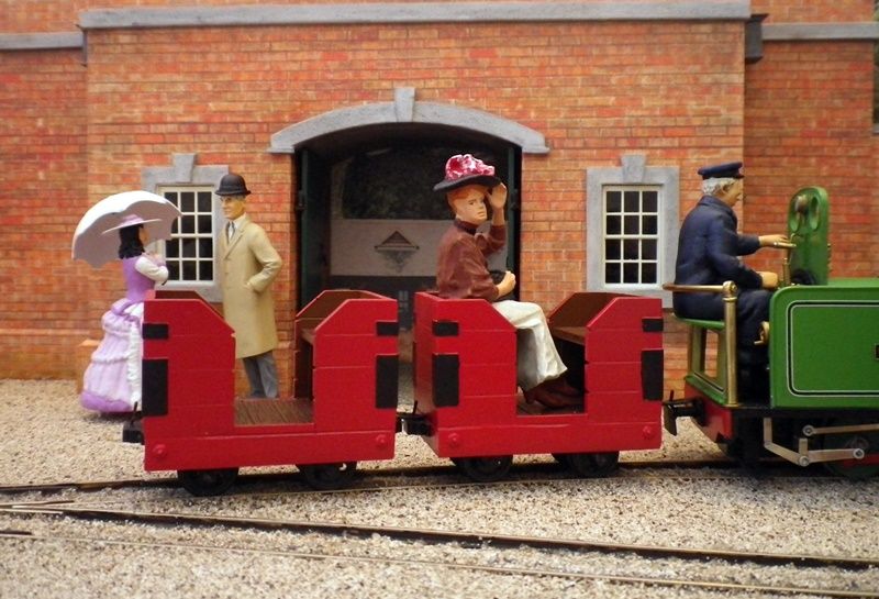

At the Patronal Feast of St Arbux a few days ago the Rev. Duncan Donats posed with Sir Macintosh and some of the estate workers outside the church after they had enjoyed their cups of coffee ...
... L-R: J. D. Wetherspoon, Graf Heinz von Pitze-Hütt, Su B. Way, Agnes Ramsden, Colonel Sanders, Arfur Biscuit, Sir Macintosh, Rev. Duncan Donats, Gari Biscuit, Letitia (Lettice) Berger-King, Harry Ramsden. In front is Sir Macintosh's youngest, Ambrosia, hoping to attract his attention, but his mind is on other things ...

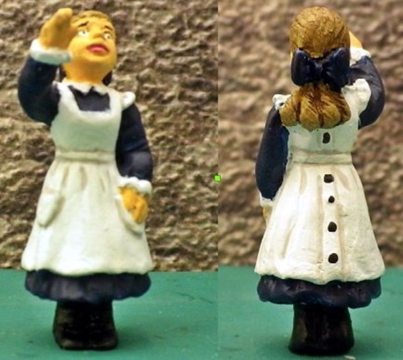

In the group photo just posted the sharp-eyed amongst you will have noticed two new figures - Agnes Ramsden and Ambrosia. These are repaints of more Lemax figures - in this case the 'Posting a Christmas Letter'
This is the larger figure, with a little height from the base added, but still on the short side ...
Igor supplied new hands. She is Harry Ramsden's wife Agnes, daughter of the Housekeeper at the Hall in Sir Sebastian's time, Mrs Lamb. Agnes is nursemaid to little Ambrosia ...
A cruel close-up, about 10 times life size!

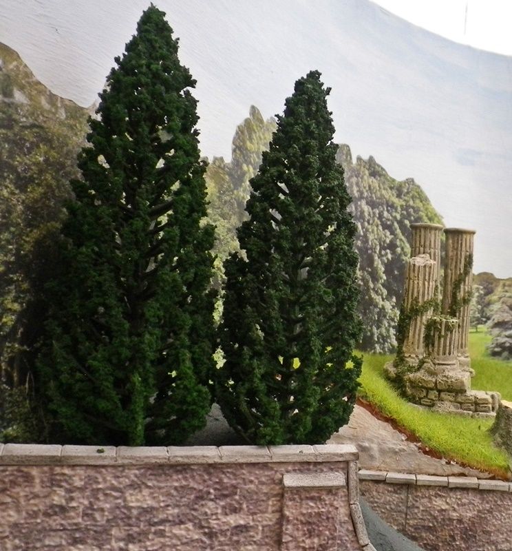

This is one of the poplars behind the loco shed - the one sprayed green.
Here are two of the unsprayed ones, just placed at the other end of the stable yard. They'll be the start of a (very) short avenue to disguise the sharp curve and hole in the backscene.
Last up are a couple of firs - just sprayed green, and placed at the left end of Temple Halt, again to disguise the hole in the backscene. There will be other trees to bulk that area up a bit.

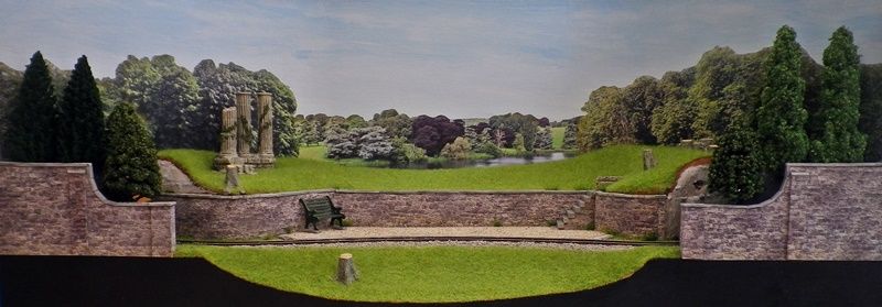

The second phase of afforestation is now complete ...
Temple Halt ...
Stable Yard ...
... and Cascades - well, perhaps "afforestation" is a bit of an exaggeration here ...

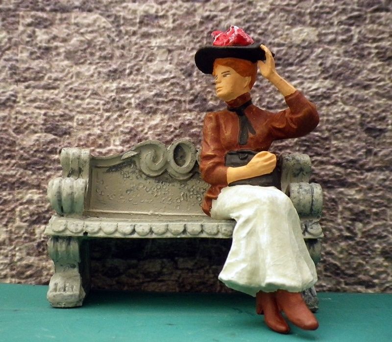

First to finish is a sitting figure. I thought I would use up some of the bits and pieces in Igor's store before they start to smell too badly. This one uses the legs of one of the Italeri truck drivers - the sitting one, although I had messed about with them a year or two back, and then not used them. The upper body is from one of those Chinese Peiser rip-off figures, and the head and hat are from the ICM 'Henry Ford' kit ...
... at some point the arms had been ripped off, so they had to be reattached, slightly repositioned for the pose I wanted. I also had to remove the briefcase from the vice-like grasp ...
... and this is the result, after much bodgement with Green Stuff ...
Image...
... from the front ...
... and the side. I think I've spotted the reason for the pained expression on his face ...

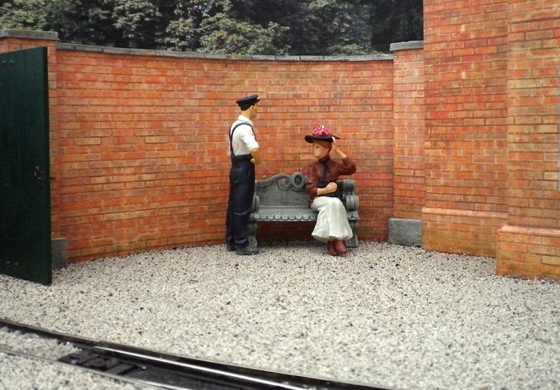

So, allow me to introduce you to Doctor Atkins, the local medical man. He's a familiar sight around the locality in his hairy gingery tweed suit. He is a Fellow of the Society of Antiquaries, and has spent much of his spare time collecting local myths and legends, rummaging in the old records in the Church vestry and the muniment room of the Hall, and digging in old burial mounds. He tells me that he has some more background on St Arbux, and I have much pleaseure in appending it herewith ...

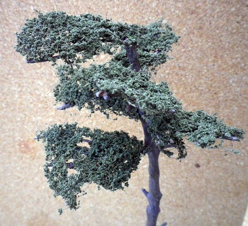

Right, another short project finished. I haven't used those blobby Woodlands Scenics trees on the layout ...
... this one. I took one and cut off the branches from the lower 2/3rds and stripped the foliage from the remaining branches. Then I added some extra branches from bits of florists wire (very appropriate) and gave it all a coat of acrylic Modelling Paste. Last step was to paint the trunk with greys and dark browns ...
... left - added branches and Modelling Paste, right, after painting.
I took some dark green texture mat, cut into small pieces and teased out, and glued on some extra texture material to build up the foliage. The pieces were then glued onto the branches ...
The final result ...
... two views of the whole tree and a close-up of the base of the trunk - the gnarled roots come from another tree I bought but didn't use.
If you think that the tree might vaguely resemble a Scots Pine - in a dimly-lit room, with your eyes half closed - I shall be content. It will go on the other side of the right-hand Stable Yard gate, outside the wall, when I rescue the layout from durance vile in the garage.
I know of no scandal regarding this tree ...

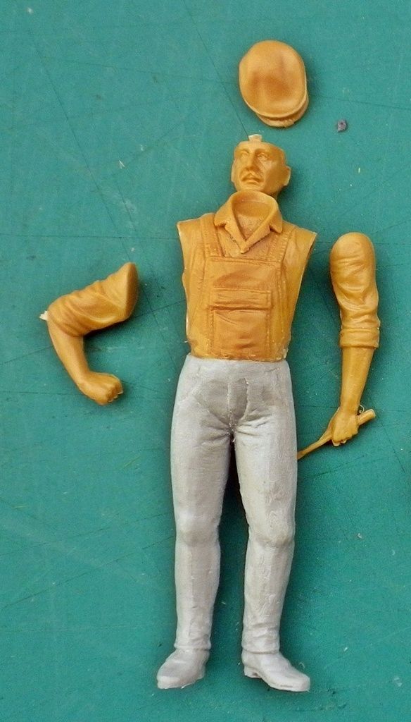

Right, the last of the three visitor-hindered projects is complete. This is another bitza job, made from body parts various - in this case the legs are from another Italeri driver, and the upper body and head from the ICM Henry Ford kit ...
... the mechanic's upper body and head is what I used for Sir Macintosh. I shaved the moustache off, and altered the flat cap into a grease-top ...
