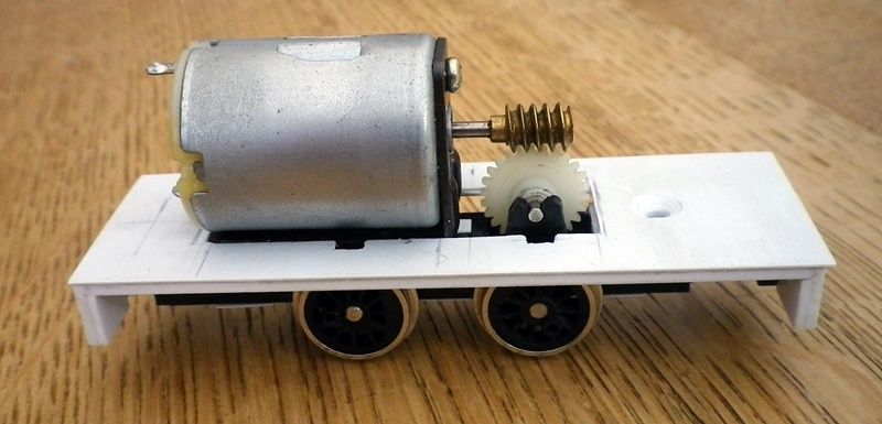

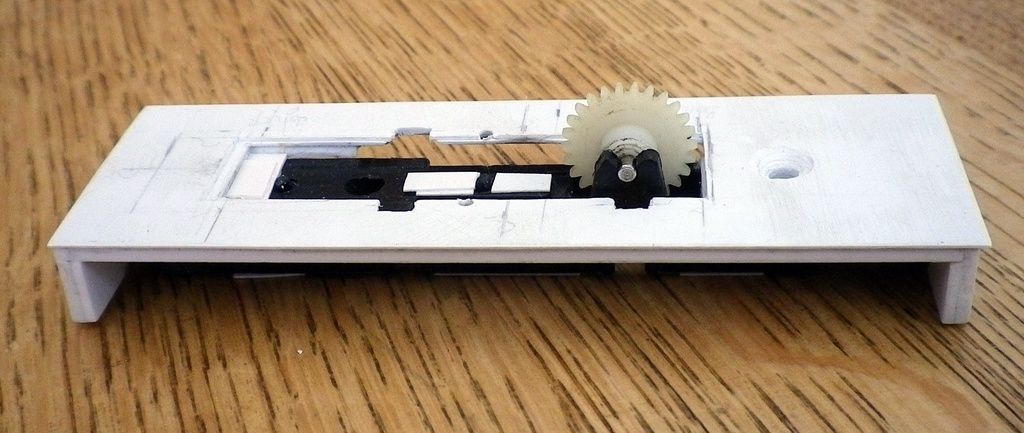

Almost a month since my last progress post here! Well, what with away days, other calls on my time, and the depradations of PB I have been getting a little work in ...
First up, the progress on 'Ettie'. To start with, the lost photos ...
The mech as bought ...
... as stripped down ...
... motor in place ...
... and a first look at how it might look.
Now we have ...
.. and ...
... all (or nearly all) the bits propped in place.
The chimney is the 'Katie' item kindly supplied by Mike at Smallbrook and cut down a little, and the dome is a cut-down 7mm scale 14xx item. More sticking little bits of plastic to other little bits of plastic produced the usual amount of shouting, but it's getting there. And I did say 'like Effie' and not an accurate representation. Maybe Sir Arthur built a second version with 'improvements' ...
Name and works plates from Narrow Planet arrived today - excellent service.

All the major components for 'Ettie' have been cobbled together, painted, lined and varnished ...
... now to assemble them into something that runs ....
On the mechanism I replaced the rather large and obvious PB-strip pickups with thin guitar string, and the thick wires leading from them to the motor with thinner layout wire ...
... the wires are taped down to the motor casing to allow the boiler to slide over everything ...
... it runs on the bench ...
The holes where the PB-strip was fixed to the frames have been filled in - hopefully, they'll be less obvious when all is assembled ...
Hours of fun ...
