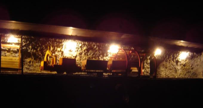

Tunnel supports refitted and tunnel lights in so time for a play in the dark :lol:
Posted: Fri Feb 02, 2007 9:09 am
Now that's super 8) Paul, great modelling :arrow: :mrgreen:
Posted: Fri Feb 02, 2007 10:44 am
Love it Paul, that makes a wonderful sight.
With the tunnel supports, I'm curious as to why they are only in a couple of places, is this to follow the prototype or purely to access the track and models :?: I can fully understand if the latter, sod's law states, if the train stops unintentionally, it will do so in the most inconvenient location :)

Yes :lol: your 100% correct.
In a Wellington City Council report on their tunnelling ' The weathered, fractured greywacke rock typical of Wellington geology is mostly "hard" in nature and will stand without additional support. Council experience is that an average two thirds of tunnels driven do not require support .....'
As you have surmised this is very nice to allow lots of room for the HOG to give locos a gentle nudge if necessary.
I have supports at either end on the tunnel so I can suspend the 300 mm diameter air exhaust pipe up in the top of the arch. I'm off to try and buy two more sections of plastic tube which will be turned to spiral steel by gluing cotton in a spiral to replicate the joint.

Very nice, really shows very well. What lights did you use, they seem just enough to show the trains and a bit of the tunnel without overwhelming the scene.
Scott
Posted: Sat Feb 03, 2007 11:30 pm
Scott,
They are just 2.5 mm diameter 12 V bulbs (rather than Grain-of-Wheat)from the local chain eletrical supply store working through a controller which was turned to about 3/4.
At exhibitions the outdoor flood lights are turned fully up to give impresson of lights rather than actually lighting the layout, I suspect the tunnel and basement workshops (still to be fitted out) will actually be called on to provide some 'real' light.
