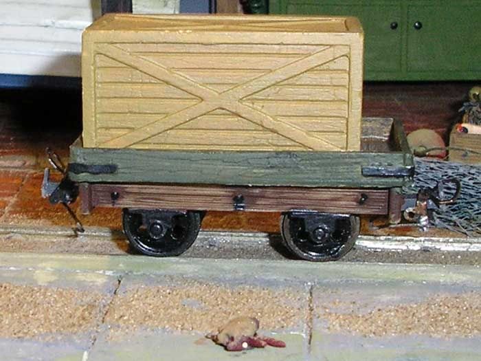

I did take the opportunity to photograph the Bemo couplers on Richards stock on saturday, so as there seems to be some interest, here they are.
First couple of shots to show what they look like and how they are fitted, these are stock Bemo couplers, the only modification is the addition of a soft steel wire soldered on to enable magnetic uncoupling as described by Richard above.
This third pic shows a wagon on the layout, if you look at the coupler on the left, you should see the couplers loop is lifted in the uncoupled position and the wire underneath which is being drawn down by the magnet. The coupler on the right is in the normal position, hope that makes sense.

Thanks Steve for posting those.
Looking through a 2004 copy of Narrow Gauge World I see that Parkside Dundas advertised Bemo OO9 couplings. These come straight or stepped shaft. From the looks of Richards I would say straight shaft.
Is that a rabbit I see before me :?:

Hi Brian, yes they are the straight version that Richard has used. I'm not sure if the stepped ones might not be easier to fit, if I remember correctly, they are stepped upward and could possibly be mounted under the bufferbeam of the wagon and not need any carving, but that is pure guesswork. Parkside Dundas normally have them in stock, they are quite popular for HOe/HOm/009 and I believe are supplied in pairs, or packs of 12.
:lol: No, that is not a rabbit, but a Crab :) dont think I got a decent pic of it unfortunately, it looks much better from above.

And here I thought it was a lost glove :oops:

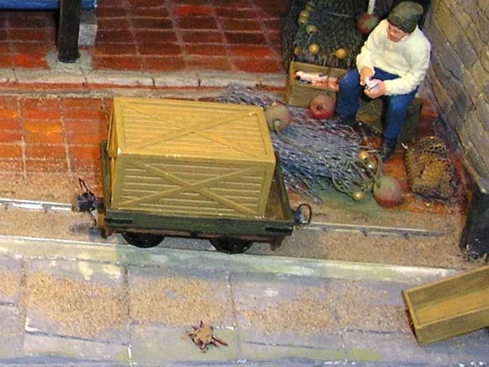

Here is another shot with the crab in it :)
