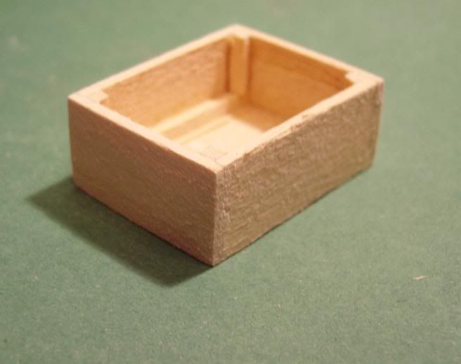

In answer to questions on boxes, this is how I produce the small ones
The box should have triangular bits in ths corners but it was too much bother to produce them, so it square stock :wink:

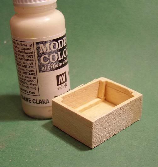

I rubbed some paint into one end of each long side with my fingure.

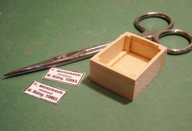

A strip of home produced transfers(decals)
Trimmed ready for soaking

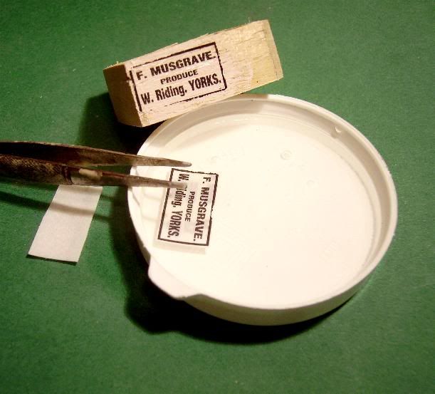

Soaking transfers to loosen backing paper with one already added.

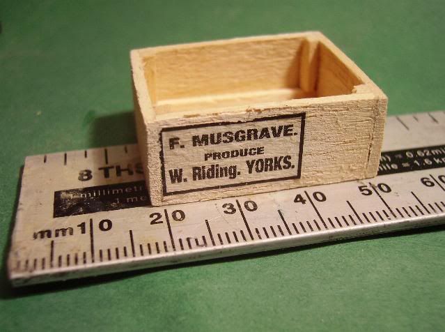

showing the size of each small box

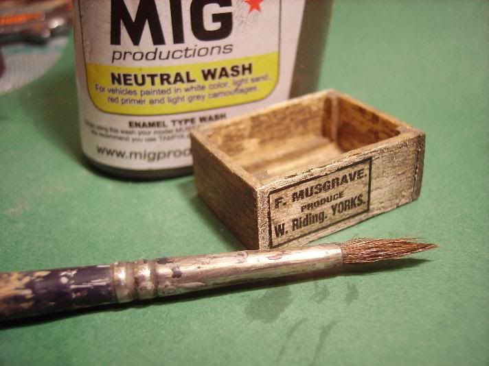

The weathering wash
Ready to join the other workind boxes :lol: :lol: :lol:

You can use an ink jet printer instead of a laser printer, but you have to coat the finished print with a water proof spray to stop the ink running when it is soaked in water.
The laser ink will not run, so it makes it slightly easier
