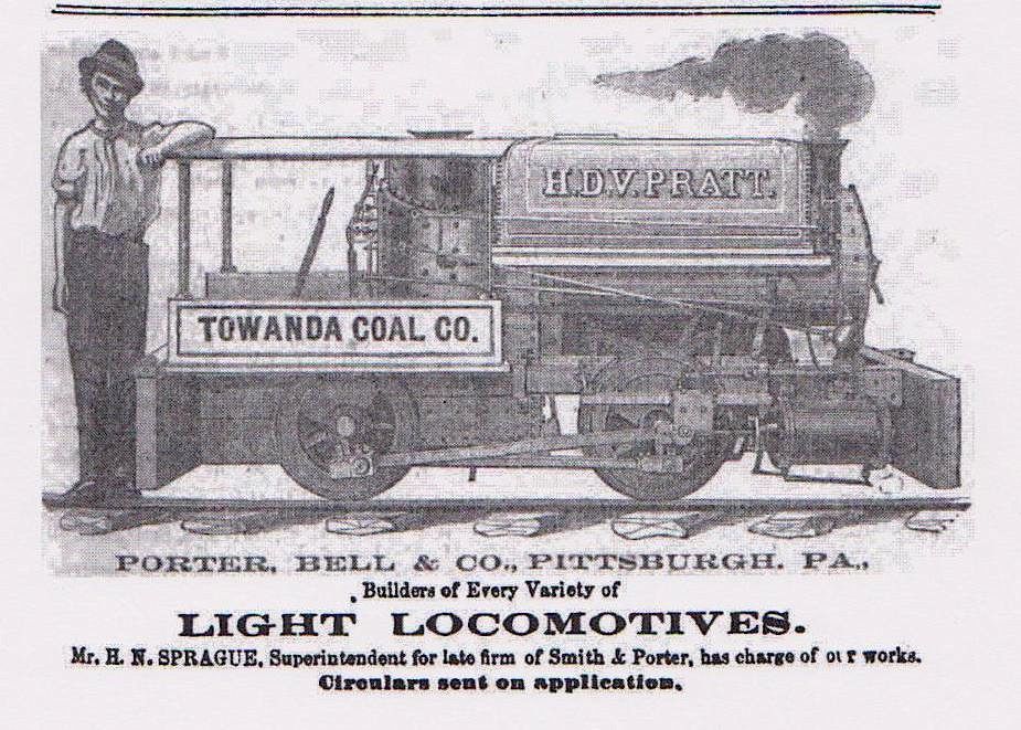

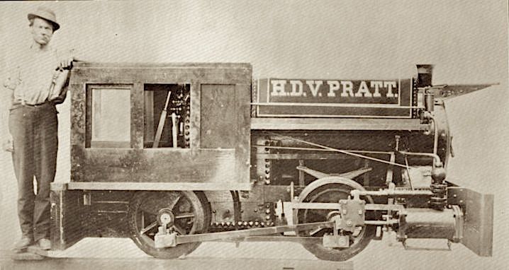

Sorry to disagree with you, Jeff, but the H.D.V. Pratt is a rather well known and documented engine. It was a 5 ton, 36" gauge Class B-mine engine delivered by Smith & Porter to the Towanda Coal Company in 1870, builder's #82. The steam dome is there, it's just very short and sits in the height of the saddle tank. The cabs on almost all the Porter mine locos were extremely low, usually at the same height as the tank. I agree that the smokestack looks small in diameter for the boiler, but this was designed when John Smith was still with the company, which would account for the English look of it.
Here's a copy of the original ad photo;
These low mining locos were surprisingly successful, even after electric, fireless and battery locos were introduced.

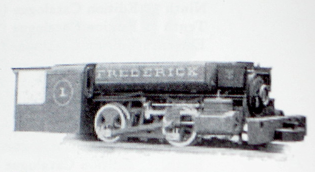

Here's one (sorry for the bad photo) from considerably later on, showing the same basic layout;

I agree the loco was built, but this photo is bodged to show effect for advertising only. All the other period references are lithographs that show an engine with open steel cab sides, and a different dome assembly.
If you look at this one, it is a standard boilered engine, with the wood cab overlayed, and the top of the saddle tank rather poorly removed. The top of the smokebox is visible at the right, and if you drew a line straight back to the cab roof, there would be no room for the top of the saddle tank, nor any dome of any kind.
The too small stack sits much too far forward (not in line with the cylinders at all), and the man's elbow is missing, as is any sort of cab roof overhang. "Pratt" was supposed to measure five feet tall overall, I'm 5'-8" -- and in that pose, my elbow is right at 53" -- even allowing for him standing on the block of wood (footboard?) the loco would come up to my collarbones at 60" tall.
Porter was well known for using the equal of "Photoshop" in their ads, as did everyone else at the time.
The second photo of "#1" is from at least 40 years later, and a different design.

Tracked down this illustration, which looks like it might be a rendering of the original engine? Perhaps Porter kluged together the photo for a catalog after the engine had been delivered? Having said that, the stack still looks small and forward.
