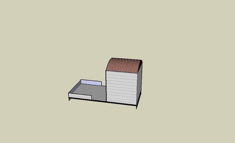

by Catweasel
This is a sketch of a works track maintenance wagon that I'm working on.It's only 72mm long by 30mm wide. Overall height is 60mm. Building on a Bachmann Caboose underframe.
