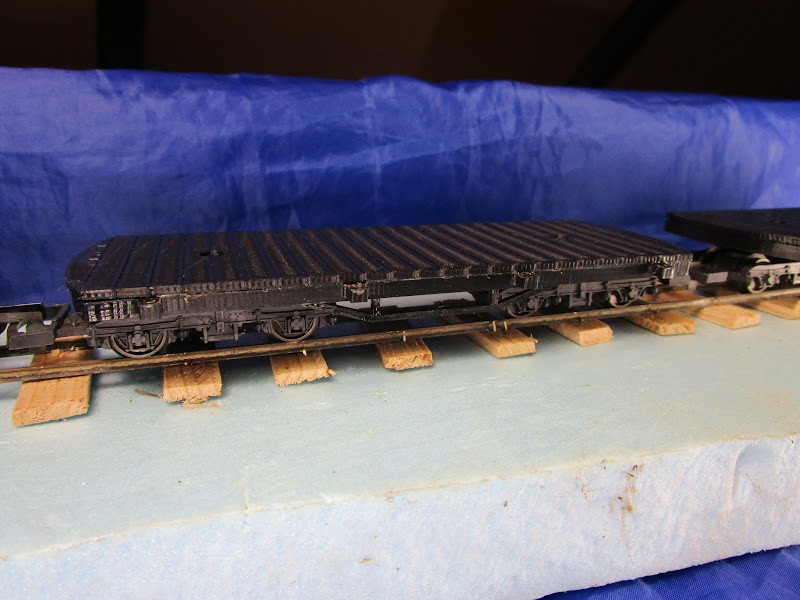

There is a reason it just sits on the chassis - in this home printing it's much easier if you don't have to use support marital and just work off a flat surface - rather like resin casting.
The problem I'm having with them is that because it's a large mass of plastic it shrinks when it cools - this tends to lift the corners off the build plate and you end up with a slightly curved bottom - in about 50% of them it's enough to make me stick it in the reject bin - you can see the once in the photo is slightly curved. I might have to go back to printing them flat packed, but you lose the detail on the inside then.
It is possible to make a frame to fit round the OO chassis to give it some more meat by printing it upside down - so you have two parts the body printed upwards and the underframe printed down. It not that much more effort/time/cost to print the axleboxs/w irons at the same time and then you have a complete chassis and don't have to buy a Dapol one.
Here is an example of a US style wagon done like that - also in 1:35 - the floor is one print, the underframe with the bogie bolsters another - the truss rods are yet another part.
