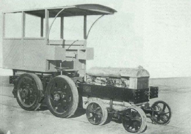

Someone commented on the precarious position of the driver. And, in the interest of comfort and safety (who isn't interested in that?) they decided to get rid of the tractor seat and have a real footplate. AND, inspired by this contraption, they designed a cab and built a prototype. :D
The inspiration:
Note the 'fenders' are part of the cab.

Nevadablue wrote:The inspiration:
Blimey Ken, they say there's a prototype for everything but that's pushing the weirdness envelope!
Great imaginative model - watching with interest :smile:
Posted: Wed Sep 17, 2014 4:55 pm
Ian, that is true. That thing is nearly unbelievable. I can't imagine how they came up with it. :lol:
Posted: Wed Sep 17, 2014 11:01 pm
by adamc
What a loco/carriage !! I can only assume that NZ never had a prohibition period :)
