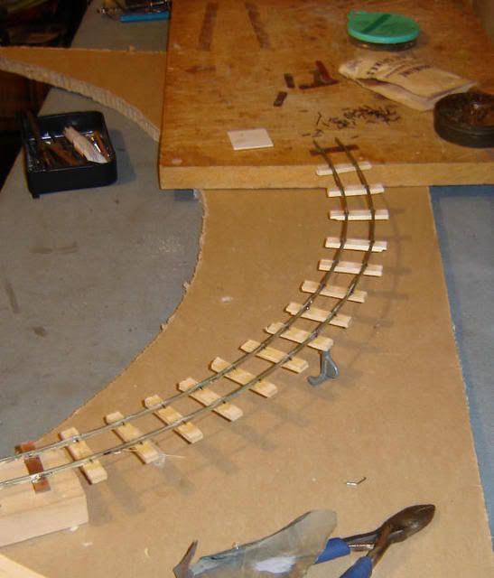

Just assembled the 'bridge' although it is probably not truely a bridge as it has no structure just piles under the sleepers. I pre-bent the rail then roughly assembed the rails with a few copperclad sleepers before super gluing the wooden sleepers in place. Once they were dry I put trackpins in all the sleepers in pre-drilled holes then snipped off the ends of the pins protruding throught the bottom of the sleepers. All the copperclad sleepers were then removed except one at each end (just in case)
Now to make 28 identical length piles :( :(
I can see the rivet counters commenting on my poor engineering so I'll have to keep a copy of the prototype 'bridge' picture handy :twisted:
Postby DCRfan » Mon Jun 18, 2007 10:44 am
:( :( :evil: :evil: :evil: Did I ever get it wrong
I measured the bottom rail height above the water level, set up a jig and cut all the piles then glued them on to the bottom of the sleepers. Only then did I realise I had not subtracted the sleeper depth so all the piles are 3.4mm too long. Anyway the bridge does not look spindley enough so probably every second set of sleepers/piles will have to go :roll:
Postby DCRfan » Mon Jun 18, 2007 11:38 am
I thought I'm not going to bed until it's corrected and it was painless but I've re-re-learnt the old addage measure twice cut once :o

Postby Steve Bennett » Mon Jun 18, 2007 11:52 am
DCRfan wrote:I thought I'm not going to bed until it's corrected and it was painless but I've re-re-learnt the old addage measure twice cut once :o
But will you remember next time :wink: I know I never do :roll:
In this case though Paul, it worked out well, the extra spacing between the supports, looks a lot better and closer to the prototype picture. I like it a lot more as you have it now, if you had cut the piles the right length to start with, you might have stuck it straight down and regretted it later :wink: Always look for a positive :D
