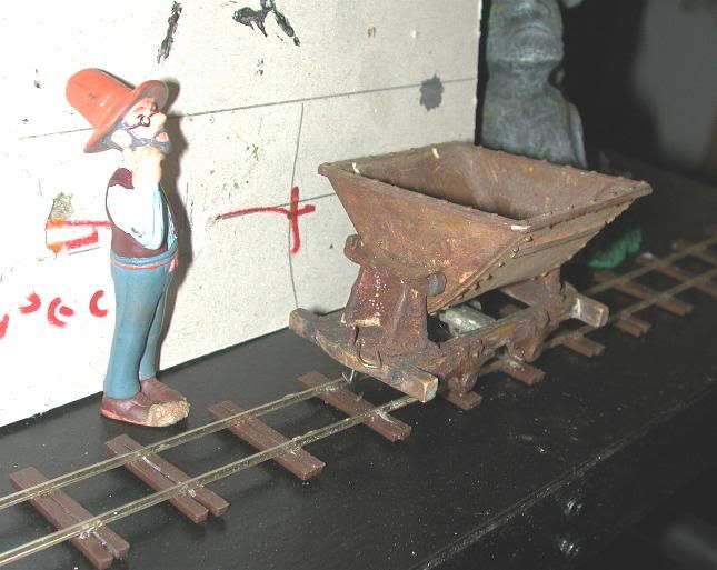

There were different methods described in this forum, how to make suitable Gn15 track. The easiest way is to bury HO or 0-16,5 track in the ground with ballast or grass, so you can´t see the sleepers.
recently I received some Micro Engineering 0n30 track. It is quite popular in the US. The sleepers are 38 or 39 mm long and about 3mm wide. You can remove the conection between the ties and push 2 together, to form a wider tie.
I placed them approx 30 mm apart for my needs.
The track is a bit lower (Code 83) than Peco´s Code 100. The switches need a few strokes with a file for some drives, e.G. the Fleischmann Magic Train, to pass.

The 0-16,5 / 0n30 / 0e Peco track sleepers are approx 32mm long. Using them in pairs mike look a bit strong. You can always work on gaps with some filler.
I tried on a little piece with removing every second tie:

I used the Peco track with the sleepers supplied, but spaced them out a bit - 3 in the space originally taken by 4 seemed about right

well you guys got my 2 brain cells working.Here is my attempt to make cheap track look better.
I took regular Atlas flex track.a piece left over cut the connectors removed some ties and pushed the rest to 1" centers.
Not bad for a cheap fix.Definitely better then the HO track I started with.Too bad I have glued the track on my test layout down.Oh well,next time.
Atlas Code 100 Flex on top,my creation on the bottom.
